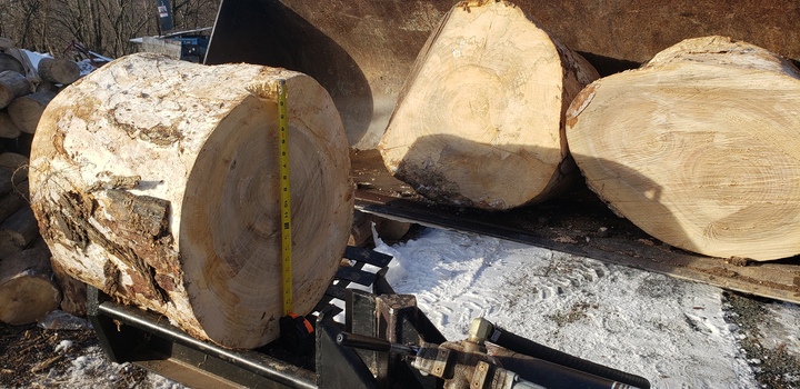

I've split lots of elm, and plenty of
larger diameter logs. This one is 24",
heavy and the grain is braided or basket
weaved.

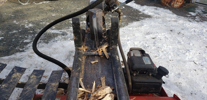

So, while sending the wedge through, it
slows, figured the 2nd stage would kick in,
I was not fast enough to realize soon
enough it was shearing and not splitting.

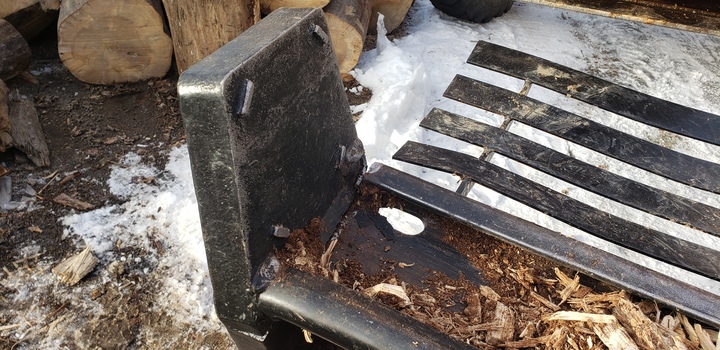

The base let loose, looks mig welded,
should have been stick welded. However,
this log should have been skipped. I don't
fault the manufacturer, or design, well
just the welds, woulda held up i think.
I'm trying to get the oem base, will
replace the wedge, will be as from factory,
base is cast steel I believe. Will stick
weld with 7018.
