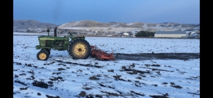

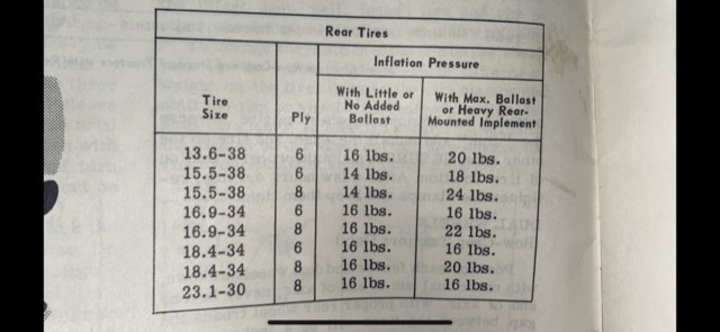

I run 22 psi when carrying my lely on single tires it weighs
3000 pounds 3020 has 15.5.38 tries
