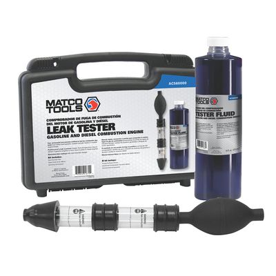

If it has mystery coolant loss, steam out the exhaust, coolant blowing out the radiator even before it gets hot, those are signs of combustion gases entering the cooling jacket.
Typically a head gasket, cracked head, or pinhole in a cylinder liner.
Stop leak will not stop that kind of leak.
There is a kit that will test for combustion leaks. Many shops have them or buy one, they are not terribly expensive. That will tell you if there is an internal leak, or a circulation problem.
