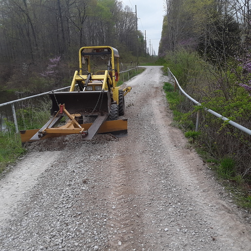

Upside you, can apply down force with the
forks touching the top side of grader
blade. Grader blade can hop using 3 pt.
I used it today to cut the outer edge of
friends gravel road and fill in potholes.
It worked better than I ever expected.
My home made forks aren't ridged like mr
titian forks are on the Kubota.
Notice in pic how much of the edge of the
road has been removed? My goal was to let
rain water run off the edge instead of
straying on road to make pothole.
