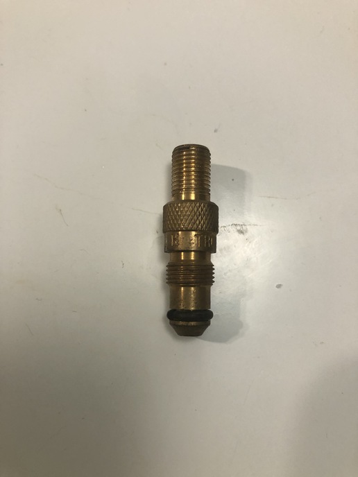

get the valve to the top block the tractor up on that side, unscrew valve, screw in new one, air up tire, remove block, drive away. wash off calcium.
