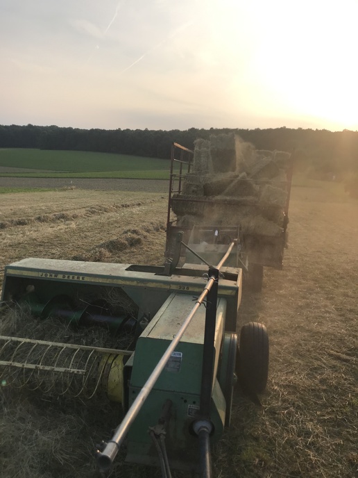

Ours use double 2x8 stringers, 4x4 cross braces and 1x6 oak fence boards length wise. The pipe sides insert into pockets in the heavy side rail. Supervisor approved. A full load is 150 bales.
