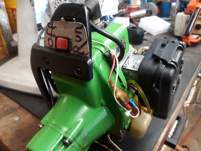

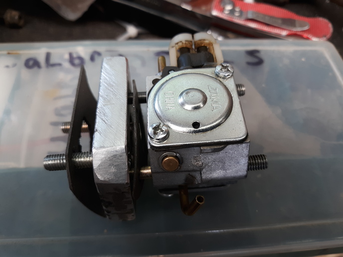

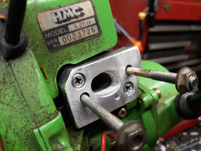

I have my Dads GreenMachine weed eater he bought in the 70's. It was getting old and needed attention. It is made in Japan and very high quality. It needed a fuel tank, carb kit and kill switch. I made an adapter and put a Zama carb on it. I couldnt get a carb kit for the TK that was on there. Adapted a similar fuel tank to it, and made a switch panel from $400.00 a square foot thin gauge aluminum. My old truck license plates.LOL It runs like a top. Actually love the Zama.
