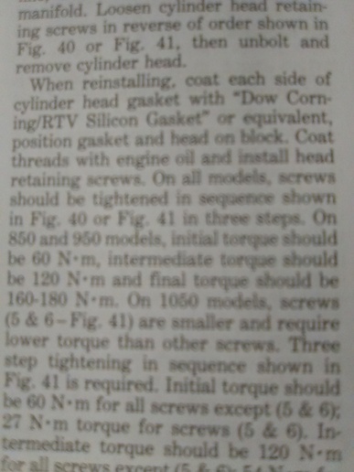

RTV silicone on head gasket. Really?
Posted by J Hamilton on October 13, 2021 at 16:06:06 from (174.250.212.189):
According to the service manual...yes. This
is on a John Deere 950 with a Yanmar engine.
This tractor came in for a head gasket
replacement and reading the torque specs and
installation instructions it said to coat
both sides with RTV silicone. Anyone else
ever seen instructions for that? I have
always read or been told clean and dry or
copper coat if you just have to use
something.
