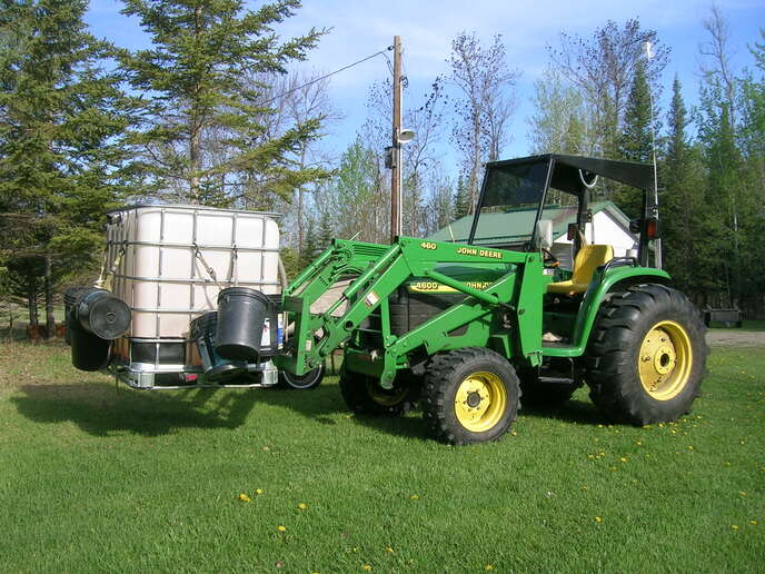

I put one on our 4600 a few years ago, I wish I would of done it 20 years ago when we bought the tractor. I use it mainly for bush cutting and mowing on our forest roads. Because it wouldn't quite fit in an 8 foot garage door with the ROPS up, I left it down most of the time, but then I got hit on the head by a small tree. So the first thing I did is cut 5 inches out of the ROPS, and then I had a local steel company bend up this canopy out of 11 ga. I was using it to water trees this summer.
