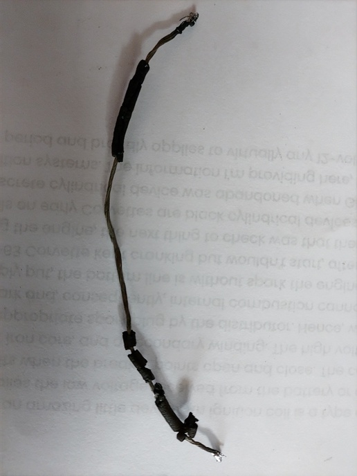

To those who responded, especially used red MN who referenced me to John T's troubleshooting guide, problem solved. the insulation around the
wire to the points from the coil was mostly disintegrated. I guess after 71 years that might be expected. Anyway, thanks again.
