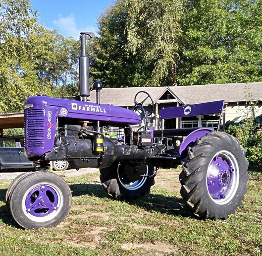

Farmall B was running ok. Carb leaked between halves( maybe warped) wife cleaned our spare and put it on. Tractor runs great. Finished up painting, seat back, and decals. I swapped out the plug wires (used a set of old ones to paint) and moved the switch. test drive! Wait.... Popping, backfire, running rough, adjust carb.... Nothing. Try the leaking carb, nothing. 4-5 hours of hair pulling frustration I check the plug wires, you guessed it number 4 wasn't hooked up! Hanging my head.
