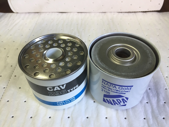

How long since engine last ran? Injection pump MAY have stuck internal parts from setting with old stale fuel. Water in fuel and/or bio diesel will cause the same trouble. Also make sure the fuel filter top outer groove DOES NOT have an O ring in it if filters are NAPA/WIX brand.
