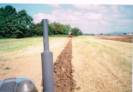

I will try and explain some of the rules but they do vary. The idea is to keep as straight as you can, cut all the ground, leaving no stubble/weeds showing, keep a constant depth, usually between six to eight inches although some go up to ten inches.
Your opening top should be level with the furrows on either side as near as possible and your closing furrow must be shallow as possible. (Something I have great difficulty in doing. I can get the opening top perfect but always make a bit of a mess with the final furrows). the judge will place a level over the starting furrows to make sure they are all even.
