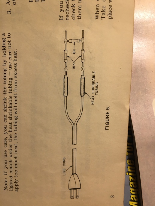

I figured it out. Found another old tach I forgot about.
Came with instructions. Two 0.1 uf capacitors soldiered on the board and Im good. It also had this cool diagram to make a test lead so the calibration pot can be adjusted before you install it in the vehicle.
