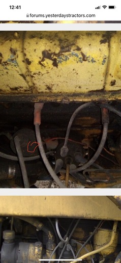

Sorry this is long but I am trying to add enough detail
for someone who had to ask what the points are and
where are they, for others see previous post. Also

so tests made with the light are valid. With the key on
you need to see if the test light shows voltage at the
positive terminal of the coil, circled in 1st photo. Now I
cannot tell exactly where the wire is coming from on
that terminal of the coil but the terminal you want to
check is NOT the one that goes to the distributor. If
that is good move to the next test which is testing to
