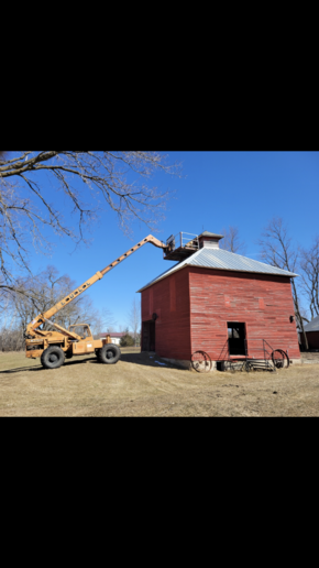

Heres one built on a local farm. The pulley at the top of the door runs the grain leg that feeds five bins upstairs which is built with laminated 2x4. The bottom is 2 inch oak joists and deck. Lower walls are 4x4 Tamack. We are taking the cupola off for the move to Junkshow. Too good, too close not to save.
