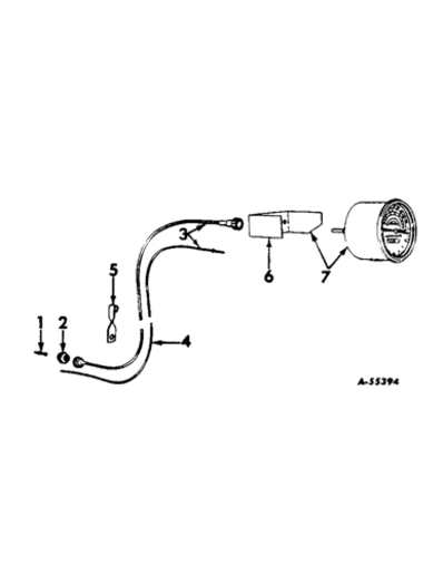

As mentioned, that is the tach cable drive and what's left of the tach cable (threaded/pinched off) on what looks to be a IH D236/282 engine. Part #3 which is #371245R91 supercedes to #401830R92
