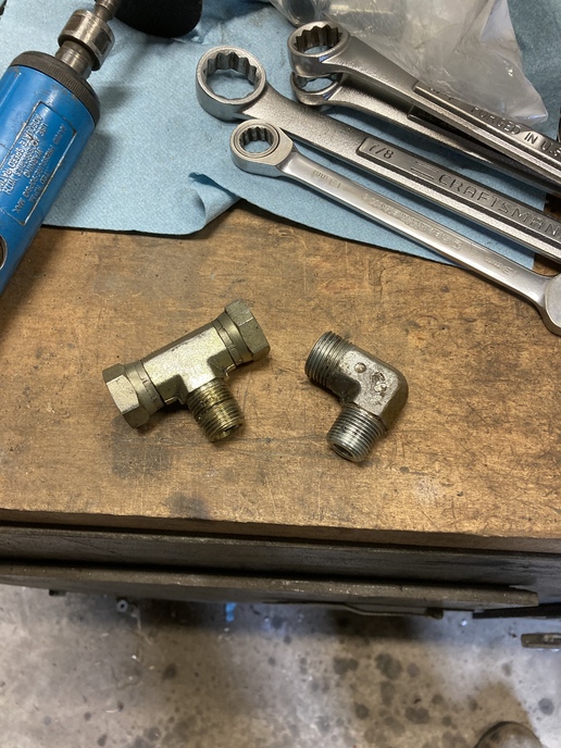

I bought a grapple bucket to put on my loader. Being the fiscally conservative person that I am, it was a used bucket, but not meant for the loader I have. So cut off the old mounts, fabbed up new ones to fit.

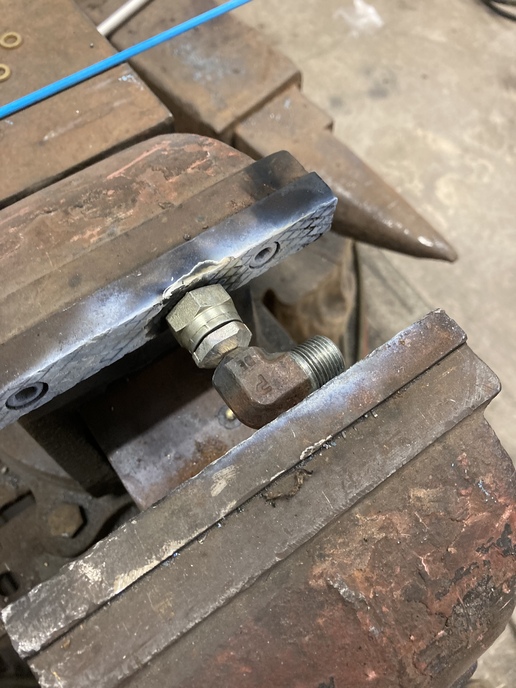

Figured Id put on new hydraulic hoses while I was at it. The only thing I didnt really think about was this bucket has European lineage. Turns out the cylinders have BSPT ports on them. I ordered some BSPT to NPT adapters, but they are a couple weeks out at least and I want to get some work done. So time to be resourceful.
