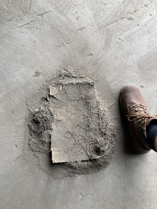

I bought a loader backhoe 2 years ago. The yard guy at
the dealership mentioned that it would run hot
sometimes. Otherwise it was in good shape so I bought it
anyway. I dont usually run it for very long at one time, so
have not had any issues.
Last weekend, I was working on a bigger project for about
5 hours and it was hot out. Temp gauge started getting
towards the red. So this morning I pulled the front end
apart to clean the coolers/radiator.
This is what all came out. Yes including the cardboard.
Size 12 boot for scale. Gotta wonder about some outfits
maintenance plans.
Ran it for 3 hours this afternoon, and now it struggles to
get up to temperature.
