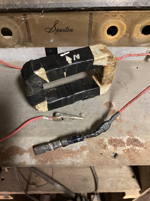

Next time you see a scrap microwave, get the
transformer out of it. Run a diode in series 110 vac,
(the primary winding) . Recharges all that magnet
will hold in one second.
