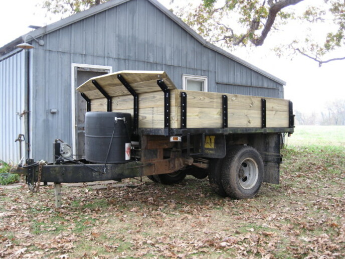

My son cut down a little one ton truck with a twin-post hoist. I used the truck pump - it was PTO driven - and I powered it with an old 8 hp Briggs engine. The pump is chain driven, and geared as low as I could gear it with the sprockets that I had available. I also plumbed it with a valve to prevent backflow so I could connect to the tractor hydraulics and dump it. It will easily dump 3 tons of gravel from the local quarry. That's about all that I want behind me.
