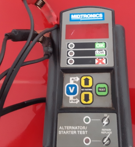

Before I went to Florida, I tried to start my 30 year old JD garden tractor. I could hear the solenoid click, the starter wouldn't engage.
When it did engage, this meter measured the cranking voltage, 11v. 12.5 volts when not cranking.
I have an electrical gremlin. I'm guessing I need to replace the solenoid. Doesn't mean the brushes in the starter don't need replaced. It may be in the key. The key may not be applying the full voltage to the solenoid.
Good luck fighting gremlins.
