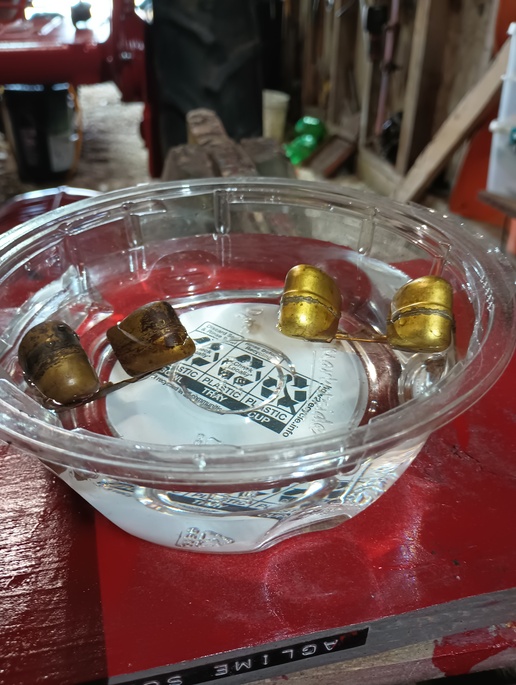

Couple days ago we fought the
carb for several hours. Tractor
wouldn't idle right and was
really running rich .... Adjusted
and cleaned, then cleaned again.
Gave up. Next morning we got to
thinking, ' what if the float
isn't floating ', sure enough!!
Got a float out of a parts carb
and we are good!! Always the
simple stuff that gets
overlooked.
