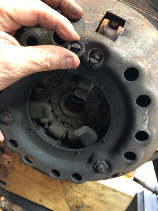

Do you know if it disengaged in the tractor with the bad trans? If it did hard to believe the below could be the problem, but maybe? This pic
is a clutch out of a 2-70 and same symptom.
I am with Mr Lund on pto shaft having nothing to do with it.
