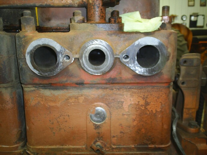

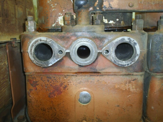

If you have a tractor that has some pits in the head at the exhaust ports and are wondering about getting it to seal up again during gasket replacement without disassembling the engine you can use a product called Quick Steel or JB-Weld Extreme Heat. I have done this on 2 other tractors and it has worked well. After wire brushing the surface good and application of the product has dried well, use a small file and hold flush against the port and file it down, moving the file in different angles but not moving it more than an inch or two as to keep it flush against the head. It is a lengthy process but it can be done and does work.
