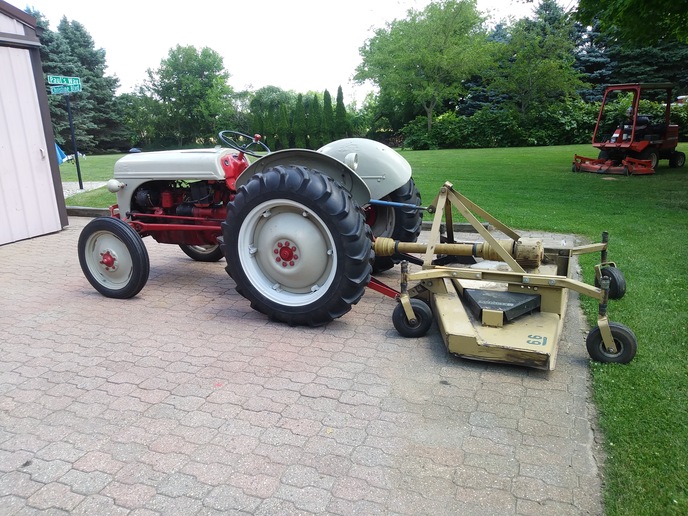

This mower was bought for a 3400 Ford. It only took me a couple of minutes to make the drive shaft
shorter to fit my 8n. If your not comfortable doing that or it isn't your equipment, just go to
Tractor Supply or some such and buy a shorter drive shaft. To answer your question, yes, longer
arms can be mounted, but other parts will probably have to be changed to make the geometry correct.
