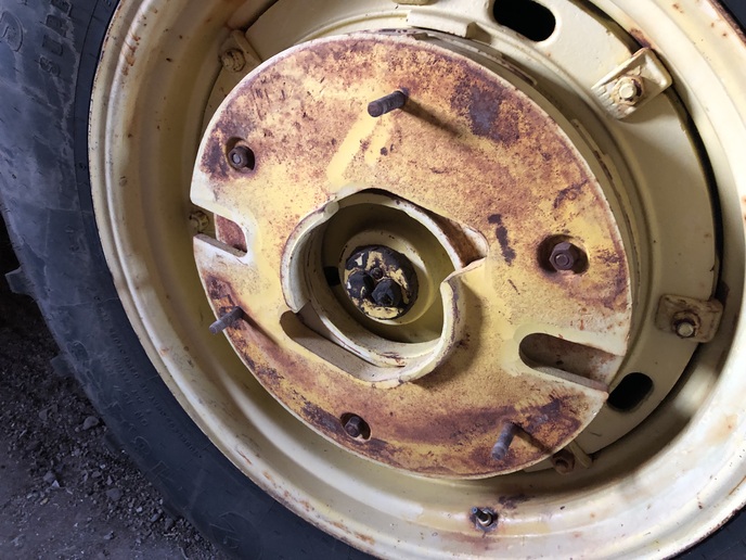

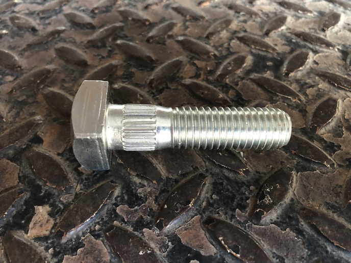

Pictures of the wheel on my JD 820 tractor shows how two different styles of weights can be assembled together as the inside weight is round center hole compared to the outside which is the more common Z shaped center hole. Also pictured is a new bolt which shows the first 1/2 inch or so has ridges to hold the bolt in place when you put the next weight on. Notice that you have to put these bolts in the preceeding weight before you mount it so you can add another weight. Many weights can be added. I have six weights on each rear wheel on my JD model R tractor.
