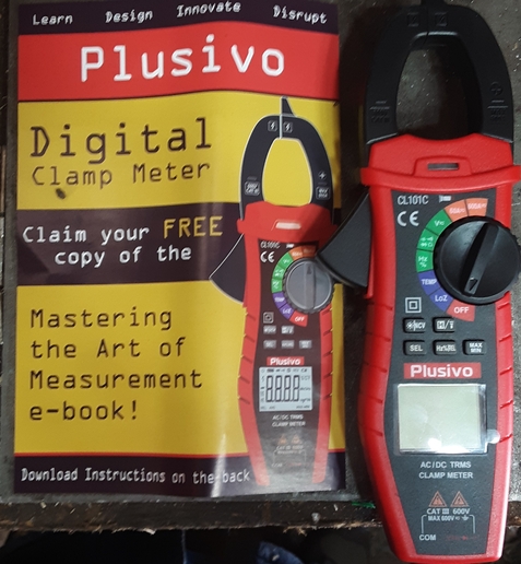

I recently bought this meter from Amazon for under $40.
I'm impressed with its ability to measure DC amps.
