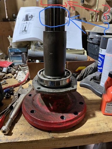

Might be lighting but highlights in red a blue need to be looked ,over ,appears the axle is driving from bull gear,s being driven out , bore in axle hub should confirm ,if larger than bearing outside diameter with bull gear is loose .
1/4 is excessive must be correctly repaired .
Whatevers holding the axle in diagrams not doing it job .
Cant see diagrams that well , you all find it .
