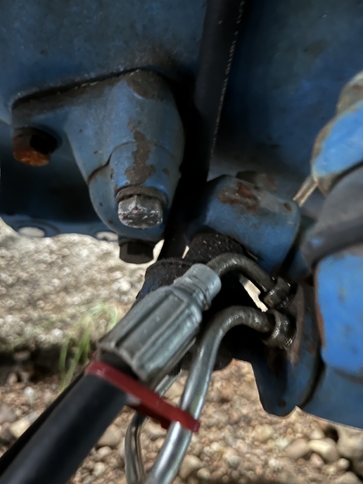

Re: rigid power steering line broke - is there a quick fix?
Posted by dcarp on June 21, 2023 at 18:21:58 from (107.77.220.33):
In Reply to: Re: rigid power steering line broke - is there a quick fix? posted by Janicholson on June 21, 2023 at 14:33:55:
As Jim suggested, on my 3910 I replaced the not available line with hydraulic line with a swivel fitting on both ends. I guessed a little long so its not the neatest installation but it works.
