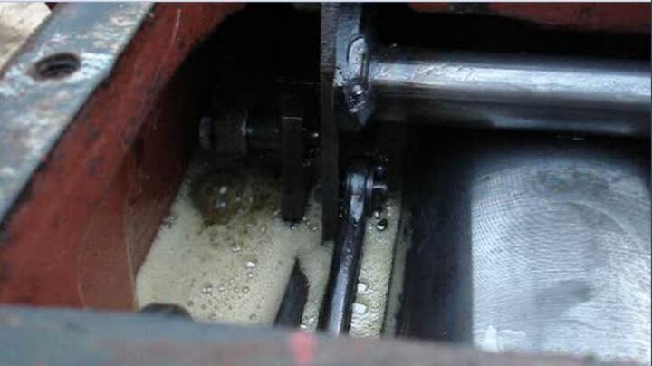

There is a metal inspection plate under the seat on top of the hydraulic reservoir that can be remove and with engine idling you should observer the hydraulic oil flowing into the reservoir.
See photo below, oil flow is on the left side, this photo shows frothing in the oil flow due to clogged suction filter.
If your B414 is a very early model it may not have the inspection plate under the seat.
Does your B414 have Power Steering, if so which version, the one with the PS cylinder on the left of the tractor or the one with the PS cylinder on the front axle?
