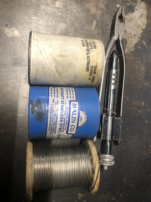

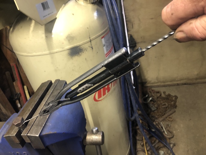

thats right they dont know how to do it. i have have seen all kinds of messes at work. there is the .032 and .041 gauge wire here i am showing for sample. the .041 is what i would use for them cap bolts. thinner wire for smaller bolts. got a little sample of how the pliars work. clamp the wire with them and pull the end knob out and they go around and around twisting the wire. but of course you need the heads drilled for the wire, and i did lots of that at work drill the heads them chamfer the holes with a slightly bigger bit , and all over head bolts had to be lockwired.
