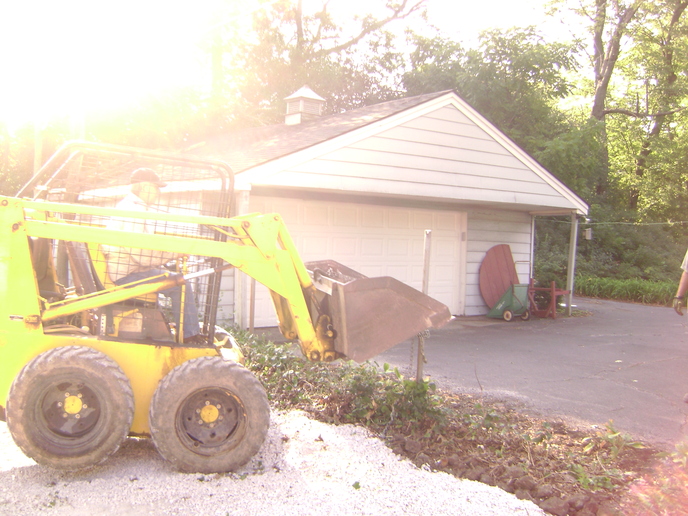

FYI: I have a 72 CL 40 and agree with used red. Mine is a v4 104 ci. Ford. The weak point on the
machined is definitely the axles. Treat them with kit gloves. I've had 1 break twice (1st time had
it repaired) and felt very lucky to find a replacement. Do not spin like a top and avoid turning on
hard surfaces when ever possible. I'had mine for 20+ years and it will do a fair amount of work.
