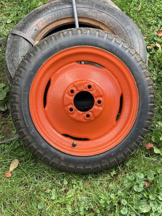

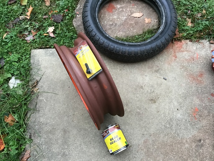

Good question , share what I did to AC traction lift model four plow with bead seal .
I used bead seal . A final step to inflating mounted tires.
This is a conversion from tube to tubeless. Traction implements tires not available in the 5.00x 16 for this plow ,so I purchased motorcycles tires off of Craigslist,ad.
Prep work was time consuming but worth the effort.
Cleaned rust beads of dirt and rust .
One rim I painted the other I just bead sealed after cleaning, to see if it mattered. Let you know in a year if it mattered. Or tire sooner deflation.
