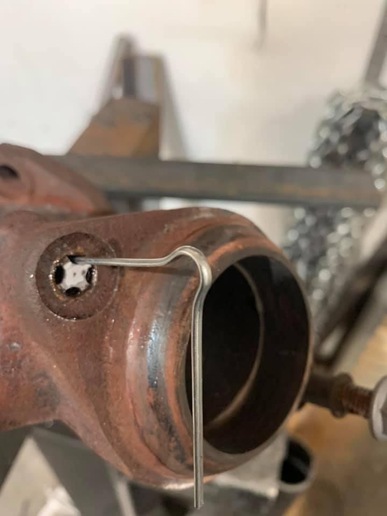

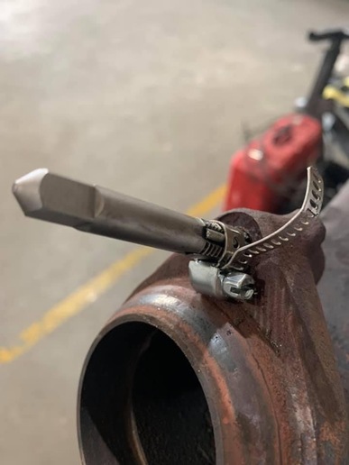

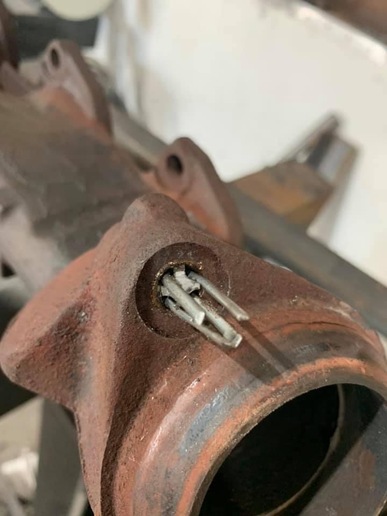

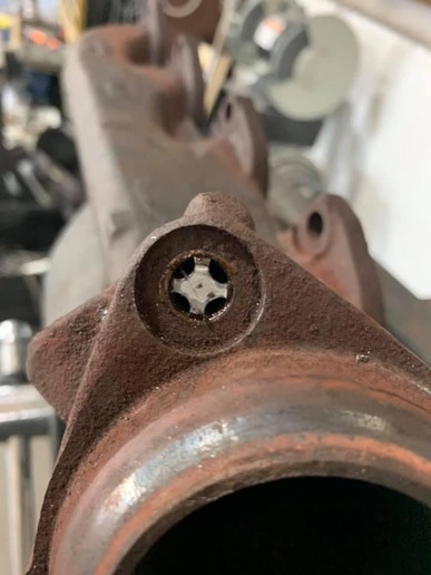

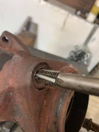

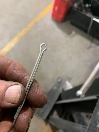

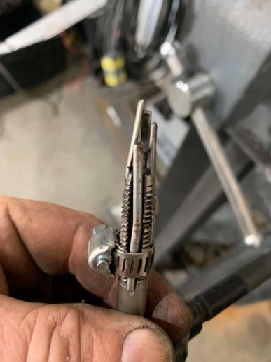

Handy hint
Posted by jon f mn on November 24, 2020 at 07:43:12 from (174.219.144.72):
Came across this on fb and thought it was pretty ingenious.
