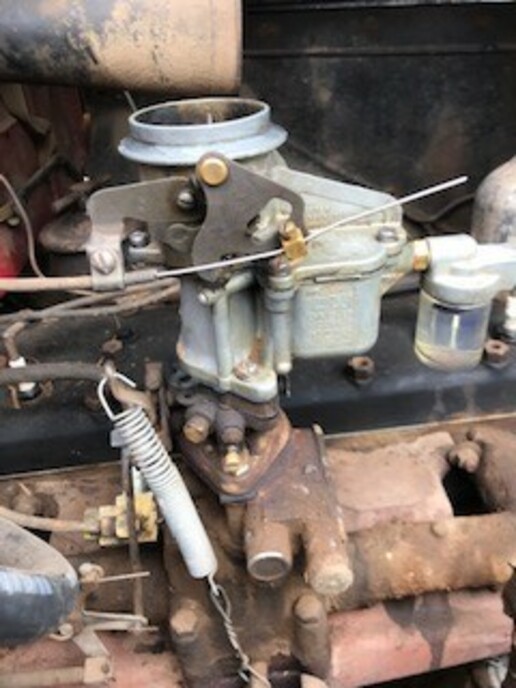

1948 Dodge B-1, Truck- flathead 6 cyl; (Grandpa's Truck); so I have kitted this carb and took it off a second time and recleaned the holes and ports; simple carb right....It starts and runs with choke about 3/4 pulled out; push choke in any or all and it dies. The mixture screw on bottom base makes no difference when running. Ball and Ball carb... Clean fuel- new pump...what do I do? Thanks guys!
