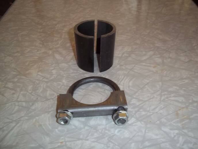

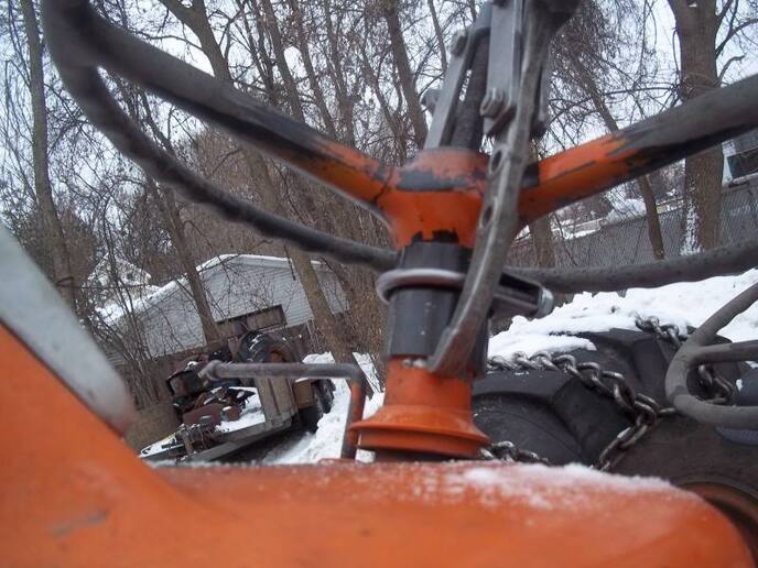

I don't have an answer about the best manual.
And I am not very familiar with your tractor.
If the steering wheel mount is similar to the older Fords I made this simple doohicky to pull the steering wheels. It pulls from under the plastic hub and does not break the plastic.
If you have already wrecked the plastic then I would use heat or take a slitting wheel on a grinder and split the hub lengthwise.
When working on machinery you do need to be resourceful as not everything is in the manual.
