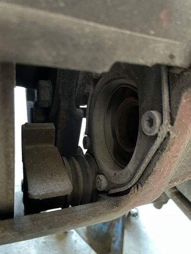

But seriously this is a class 8 single axle truck.
As you can see the left outside brake pad is completely gone.
The caliber pistons are riding right on the rotor.

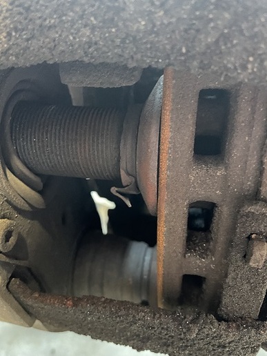

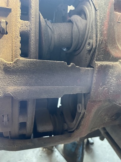

The right side is even worse.
The outside pad is gone; one of the caliber pistons is gone; and the other piston is about to fall out.
How someone could drive this truck and not notice something was wrong with the brakes is beyond me.
But my question is.
I can understand the pistons might be able to fall out with no pad to hold them from over extending.
What I do not understand is how did the pads fall off.
I just can not believe both outside pads broke apart and came out in pieces at the same time.
I thought calibers were made to where even if the pad was worn down to the metal there was still not enough clearance for the pad to fall out.
Your thoughts
