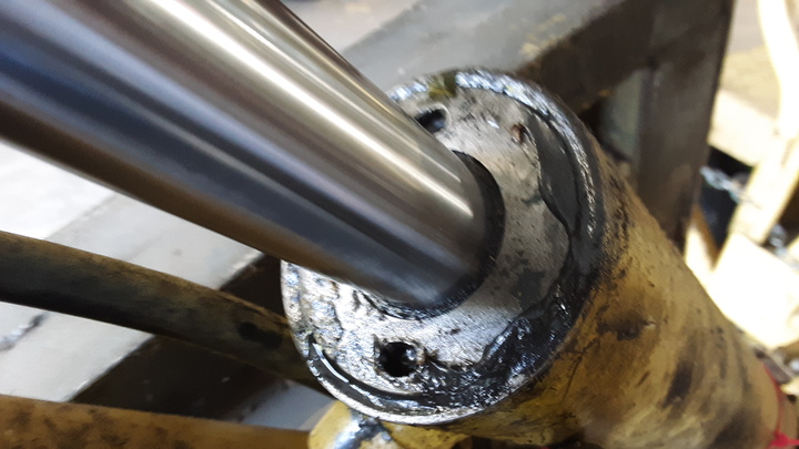

Jim,
I hate the way my cylinders are built.
Rust can form between the retaining
Wire and the O ring.
I replaced this cylinder because I
couldn't stop it from
Leaking.
Now after rebuilding I pack grease around
the wire in hope it won't rust.

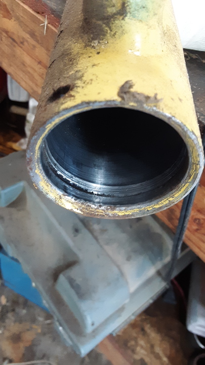

I need to fill in the rust pits on the end
of the cylinder. No moving parts.
I got something in the mail today that's
supposed to build up the metal.
I have to try something. Can't see how it
will hurt.
Glad my first terramite wasn't abused like
this one.
A 4 inch 400g hone might help rebuilding
the rusted area.
