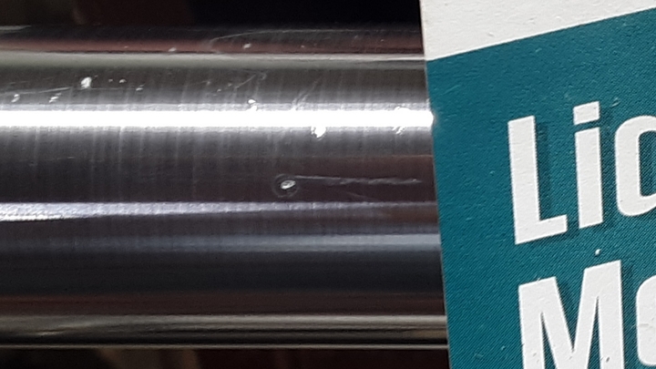

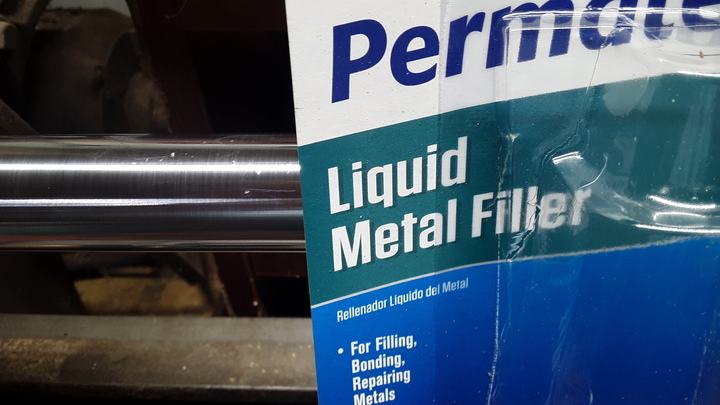

Permatex liquid metal used to fill tiny pits on hydrauli
Posted by Geo-TH,In on August 25, 2022 at 14:52:21 from (184.19.55.57):
You can feel the imperfections in the rod
better than you can see them.

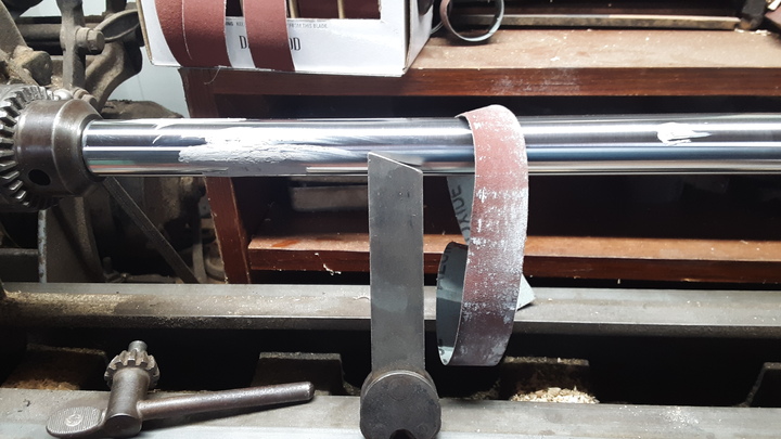

I used 600g for my final sanding.
I held sandpaper against the rod using the
flat metal tool.
I enlarge this pic.
You can't feel the pits filled with liquid
metal.
Don't get nervous.
All fluid
Returning to the tank must pass through
the hydraulic filter.
I think this will work on my cylinder rods
which were damaged before I bought the
terramite.
I've tried epoxy. Doesn't work.
Do you use anything better than permatex
liquid metal?
I let the liquid metal cure for a week
before sanding.
