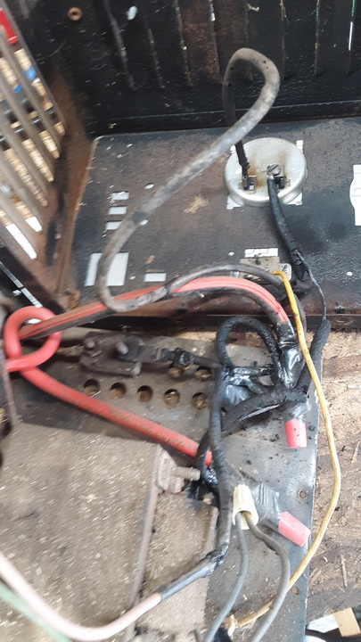

This ie what wires look like when the smoke is gone
Posted by Geo-TH,In on September 19, 2022 at 12:21:28 from (184.19.47.130):
This is the inside of my 50+ year old manual battery charger after I forgot to pull the power cord and the charger wires touch
each other.
Good news transformer is good.
Bad news need a couple of wires, a pair of diodes and replace the circuit breaker with a fast blow fuse so this can't happen again.
