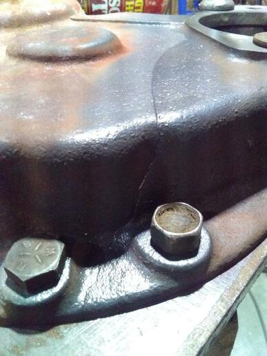

Braze it or weld it?
Posted by stevieb49829 on December 01, 2023 at 22:19:36 from (98.97.112.20):
This is a timing cover off a Continental Flathead. I cooked it in my wood boiler. Its bolted to a 1/2'' strongback plate, and I'll preheat it in my wood boiler. My rods say preheat to 7-800. For the most part, it's 3/16 cast where it's cracked. Would you braze it, or weld it with good cast rod in the stick welder. Also, I heard you can braze with a TIG, which I also have. Is that an option? steve
